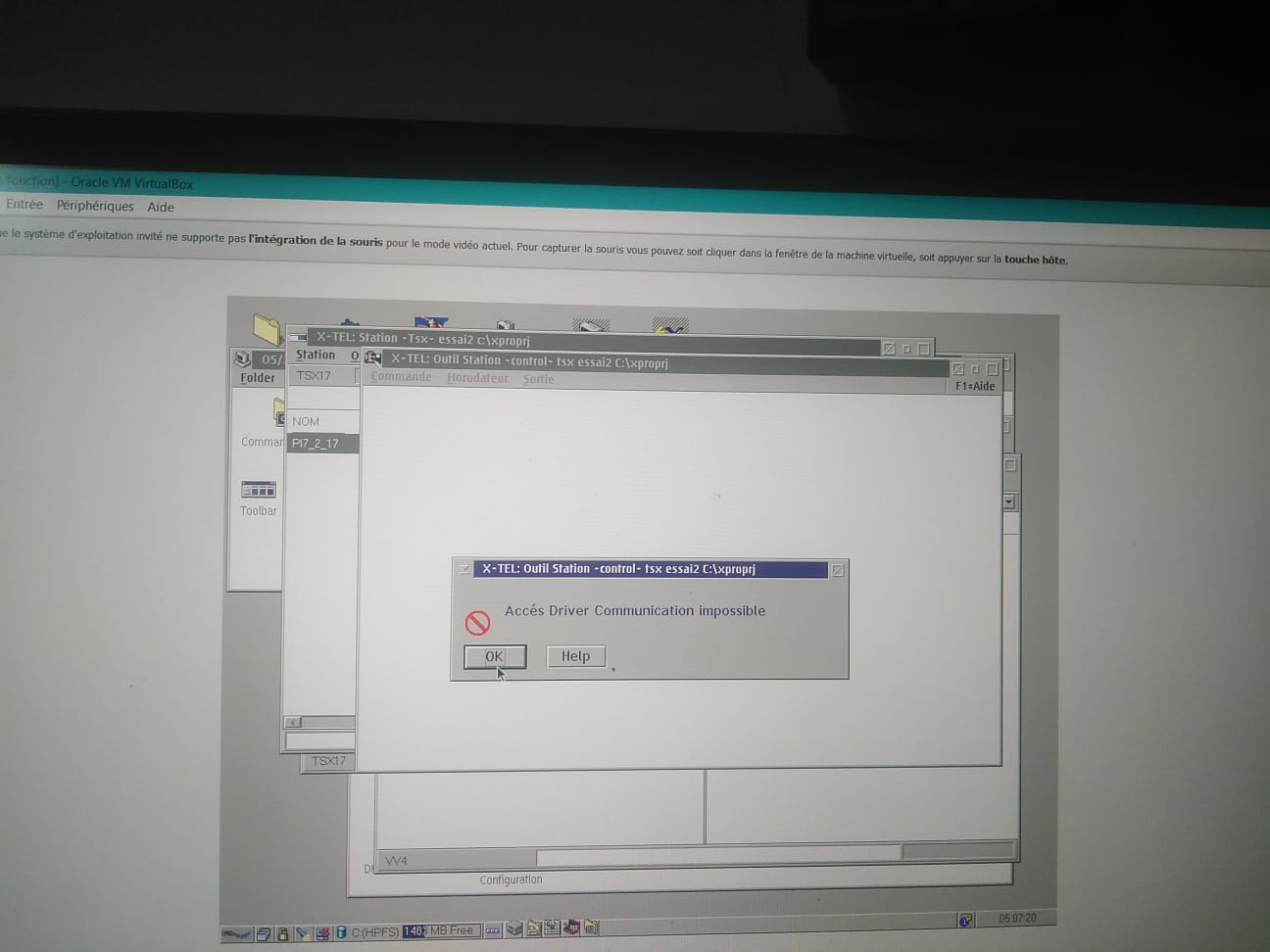

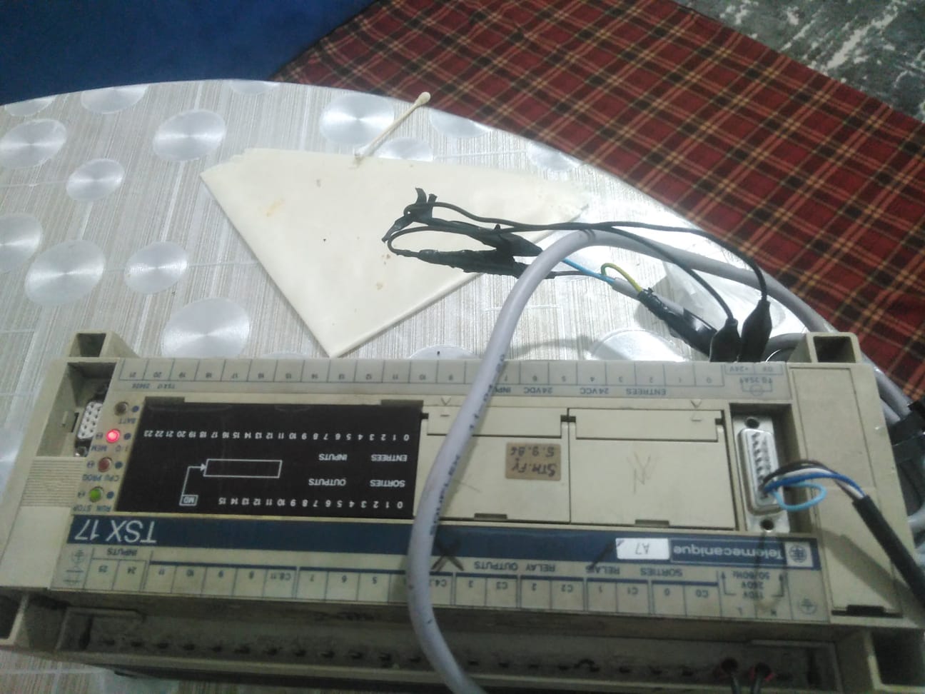

i have a tsx17 20 after sevral days of trying to connect with this plc i couldn't make it work

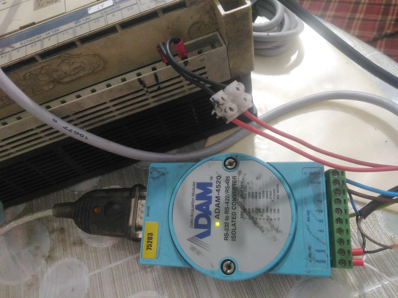

i have a serial adapter rs232 to usb and i have rs232to rs485 i made i home cable i instal xtel workshop inoswarp but nothing work
could any one show me the road to get it done i have being struggling for weeks to do it

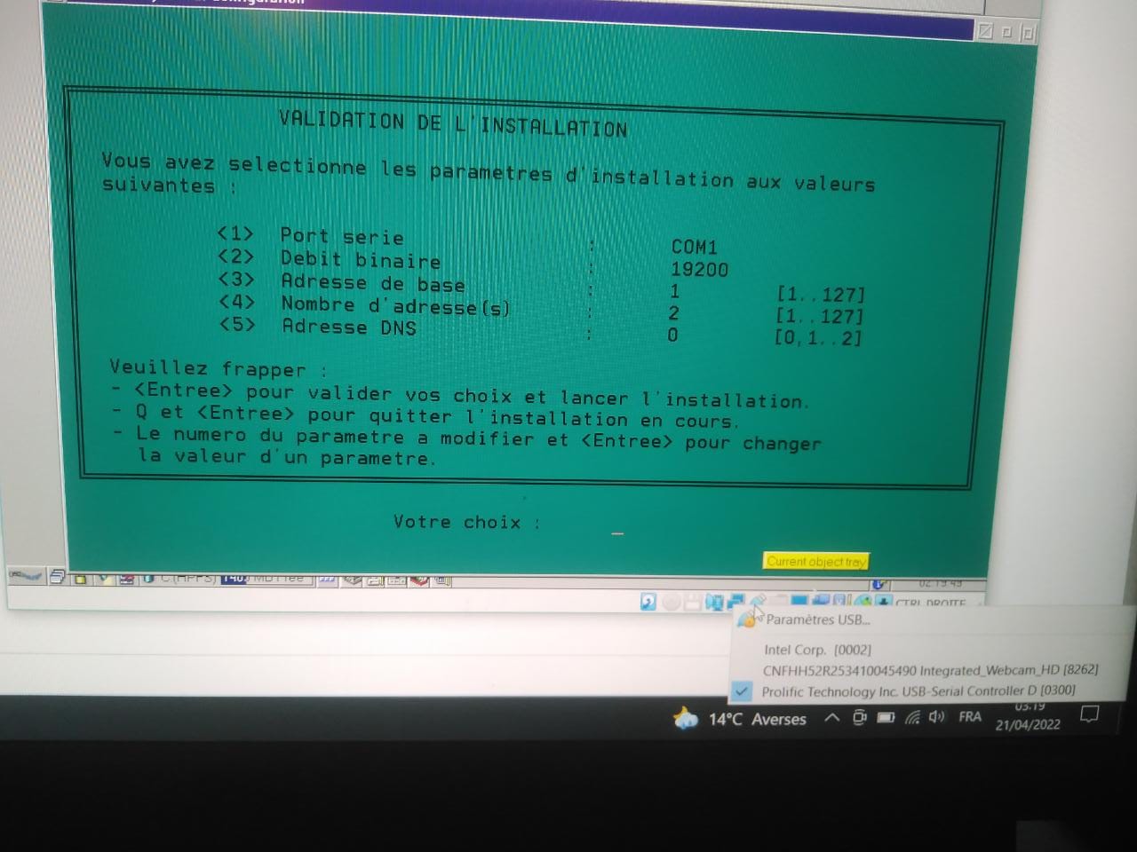

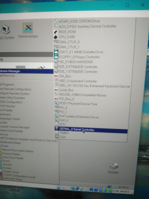

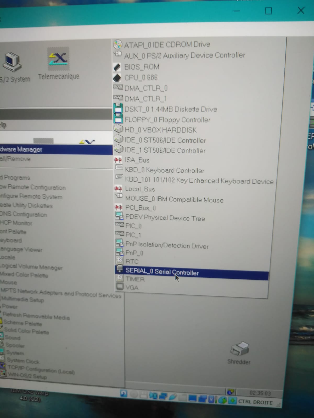

in Config.sys
DEVICE=C:\XPROSYS\EXE\DTSXPC01.SYS COM=COM1 MAXSPEED=19200

MERCI INFINIMENT POUR TON réponce @itasoft
aprés un redemarage le driver est instalé mais encore pas de comunication
